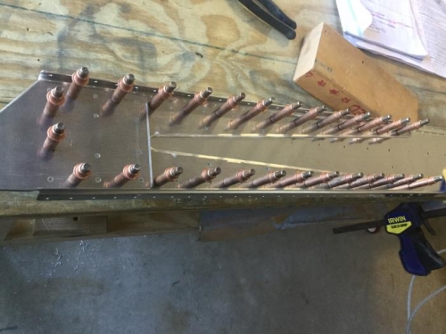

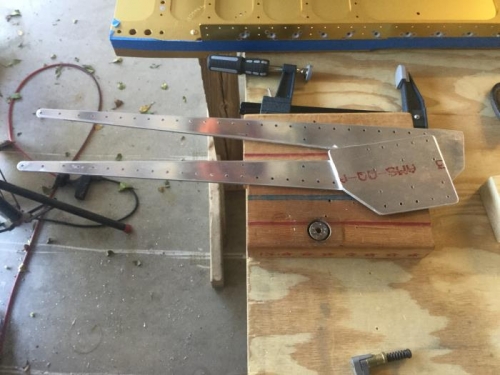

Match drilled W-707E and F to the Rear Spar. Final drilled W-707G Reinforcement Fork and W-707D Rear Spar Doubler Plate. Trimmed them first according to DWG 38 using a bandsaw and 6" Scotchbrite. Deburred all holes. All parts ready to scuff, clean, and prime.

Right Wing Doublers on Rear Spar
Right Wing Fork and Doubler Ready for Scuff, Clean, and Prime
Righ Wing Fork and Doubler Final Drilled
