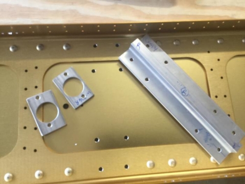

- Installed nutplates on W-423 Splice plate.
- Installed nutplates on bottom wing skin access cover holes.
- Added touch up primer to all countersinks on Left Main Spar.

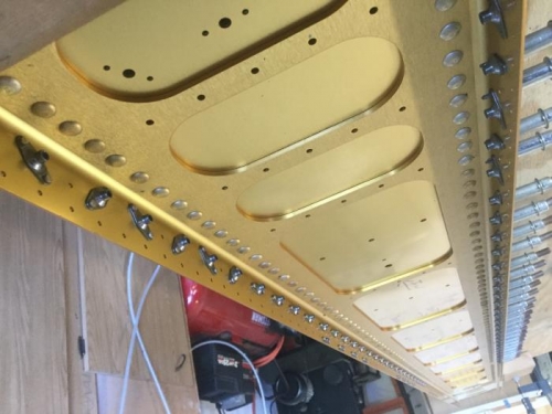

Right Wing
- Installed nutplates for Fuel Tank and Access Plates
- Dimpled Access Plates
- Countersunk Main Spar flanges for Fuel Tank and Access Plates. Used the nutplates as pilot guides for the cs bits. There was some chatter on the fuel tank countersinks. Tried different speeds but not luck. Should have tried an electric drill to get the slow high torque available. But, these holes don't carry any load. The nutplates transfer the loads to the spar through the 2 -3 rivets on each nutplate.

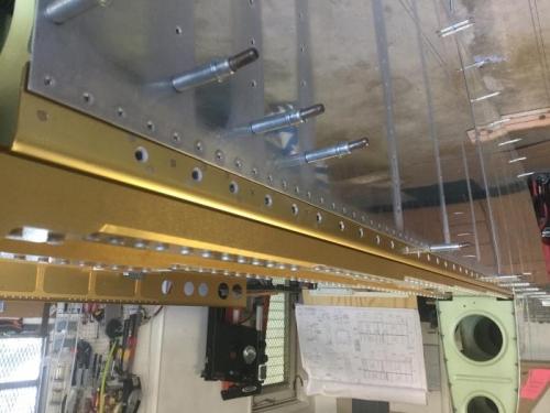

- Match drilled the Tie Down and Spacer Plates to the Main Spar. Match drilled for the 4 nutplates, but will prime before installing.
- Installed two nutplates for the Center Section on the inboard web of the Main Spar.
W-423 Nutplates and Primer in Countersinks
Right Wing Tie Down Match Drilled
Right Wing Nutplates
