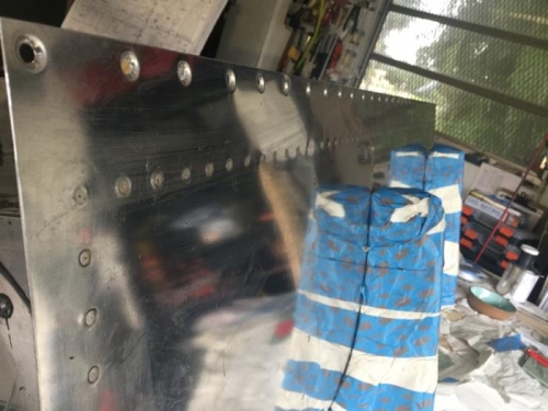

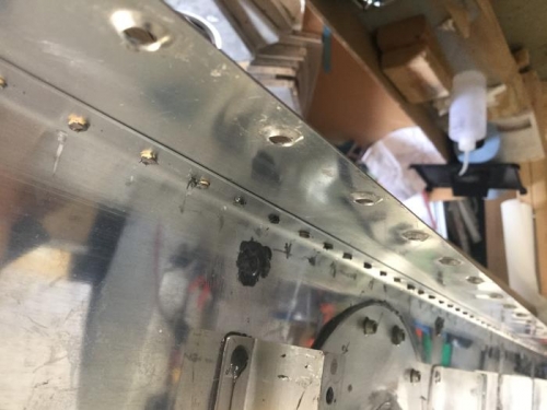

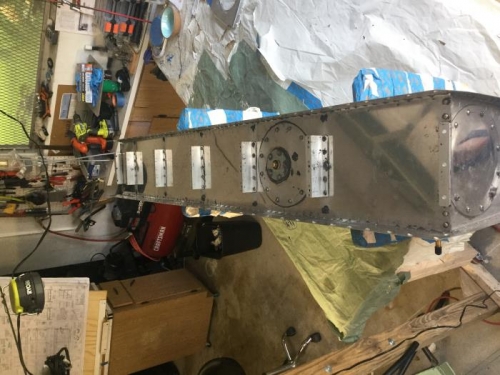

Riveted and sealed the Left Fuel Tank Baffle and end Z-Brackets.
Even after careful layout and marking, I STILL but the Z-Brackets on the wrong end. Drilled them out and redid them before the Proseal setup. Messy, but not a big deal. Some of the Skin to Baffle rivets slid a little to the side on the shop head using the squeezer. Despite all efforts to keep the squeezer from moving, the Proseal made it impossible to keep it from sliding a little one way or the other. NOW, to wait and do a leak check in a few days. I'll work on the rest of the wing in the meantime and give the Tank plenty of time to cure.
