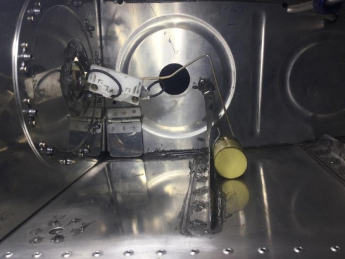

Bent the Fuel Sender to move fully from the bottom to top of the Left Tank. It's not in the lowest or highest parts of the tank, but close enoigh.

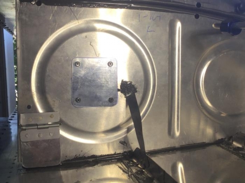

Per Vans email direction and others on FB, I covered the large hole in Rib #2 in the Left Tank. I just used 4 pop rivets to fasten it.

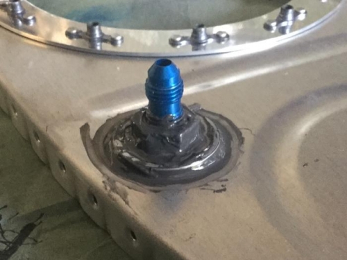

Installed the Fuel Vent Line fitting on the Left Tank. Torqued to 65 in-lb and used Proseal between each part and then over the torqued edges.

Fuel Sender Finally Bent Well
Covered Rib #2 Hole
Vent Line Fitting Installed, Torqued, and Prosealed
