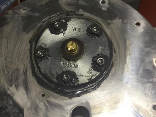

Drilled out and re-riveted the proud rivet on the Fuel Cap. Still not perfectly flush, despite great care with the squeezer, but much better. Used Proseal to install and cover the shop head. The 3-4 Rivet left a thin shop head on this one rivet, but good enough.

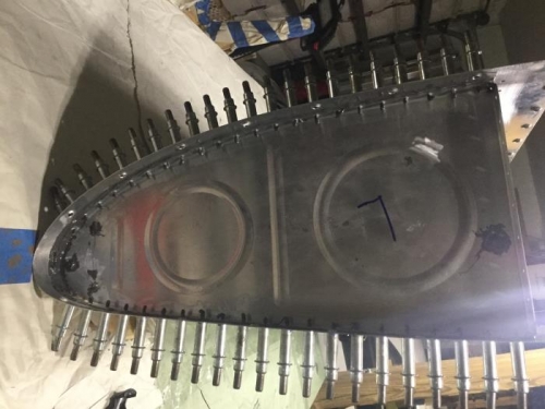

Riveted the reinforcement plate onto Rib 7 with Proseal. Prosealed and clecoed Rib 7 on the Left Fuel Tank.
Bent and installed the Vent Line. Bent at outboard end to be just under the skin. Prosealed it into the Hanger.
Installed allen head screws into the Fuel Sending unit with Proseal.

Left Fuel Tank Rib 7
