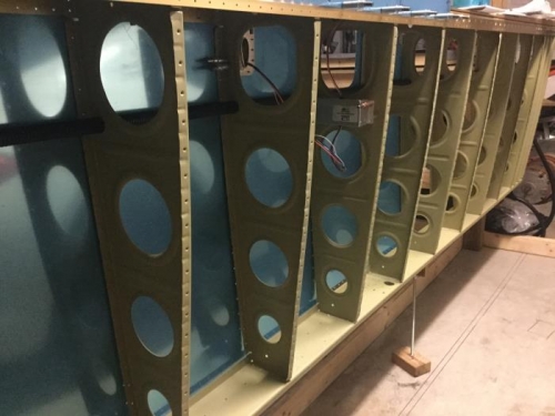

Brief Description:  Left Wing - Dimpling and AOA/Pitot Install

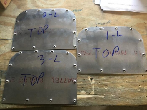

Deburred and dimpled:
- Access Covers

Drilled out Bottom Skin for AOA/Pitot Mast. Came out very nice. Drilled all the attachment holes for the Mast and the small angle bracket that goes in the wing. Also, drilled four holes in a rib for the heater Controller. Drilled to #28.
Made scarf joints on top and bottom skins.
Left Wing Access Covers

Dimples in Top Ribs, Heater Controller Clecoed, Pitot Mast Bracket Clecoed
