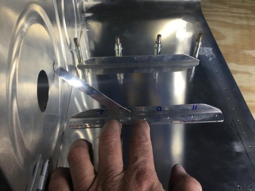

Deburred all Left Fuel Tank parts. Dimpled all Left Fuel Tank Ribs.
Made Anti-Hang-Up Guides for Left Fuel Tank. Installed the one on the 1st Rib. Installed one side on the other one. Need to have the Skin on to finish the second hole.

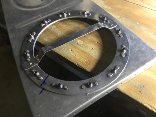

Cut the Access Holes in both Root Ribs. The flycutter worked great. Carefule, the pieces are jagged and RAZOR sharp afterwards.

Cut Access Holes in Both Root Ribs
Fuel Tank Anti-Hang Up Guide
Fuel Tank Anti-Hang Up Guide and Reinforcement Ring
