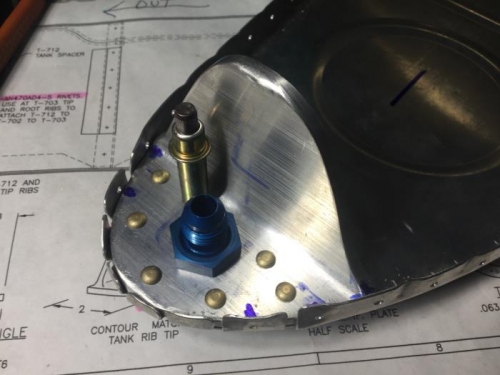

Brief Description:  Left Fuel Tank - Nose Reinforcement, Fuel Cap/Flan
Match Drilled both Left Fuel Tank Nose Reinforcement pieces to the Rib. Used 6 #4 Rivet Holes and the single #6 Rivet Hole (match drilled from tooling hole). Also, added the 9/16" hole for the Fuel Pickup elbow.

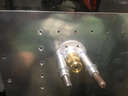

Match drilled the fuel drain flange.

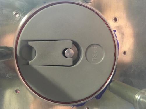

Enlarged Fuel Cap hole to fit the upgraded caps/flange. Used a 2.5" Hole saw then a scotchbrite wheel to get the final 2.55" dimension. Came out looking very good.
Nose Rib with Fuel Pickup Fitting
Left Fuel Drain
Left Fuel Drain
Left Fuel Cap
Left Fuel Cap
