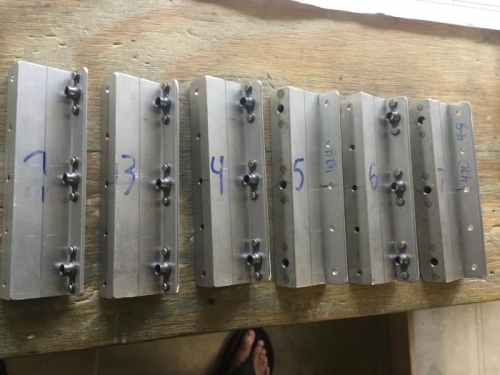

Brief Description:  Made T-405, L.Fuel Tank Stiffeners, Z-Bracket Nutp
Fabricated both T-405 Brackets. These are the L brackets on the outside of the inboard Fuel Tank Ribs. See pic below. Came out nice, but still have to think about rivet shop head clearance where the Skin rivets to the Rib.

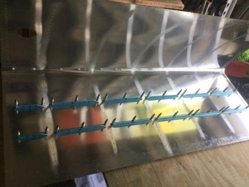

Match Drilled all the Left Tank Stiffeners. Need to deburr the holes on them and the skin.

T-405 Brackets for Both Tanks
Left Fuel Tank Stiffeners
