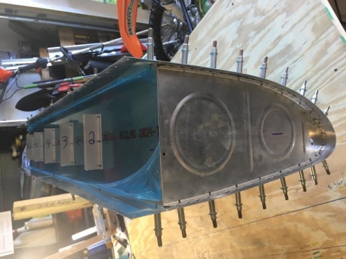

Finally got the Left Fuel Tank Skin clecoed to all the ribs and Baffle. Then match drilled all the Rib and Baffle Holes. Opened up all edge holes, used to mount the tank, to #19. Countersunk all the Skin holes that will be riveted to the Baffle.
Fit Tank on Wing and ensured there was no clearance between the Tank and LE Skins. Clecoed through the Spar Nutplates. Match drilled all the Doubler Plate holes to #19.

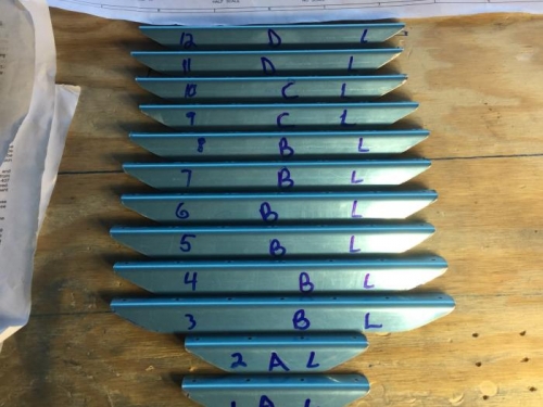

Trimmed and smoothed out both sets of Tank Stiffeners. They turned out very nice. Wish everything was this easy!

Match Drilling Skin
Match Drilling Skin

All Tank Stiffeners Cut and Prepped
