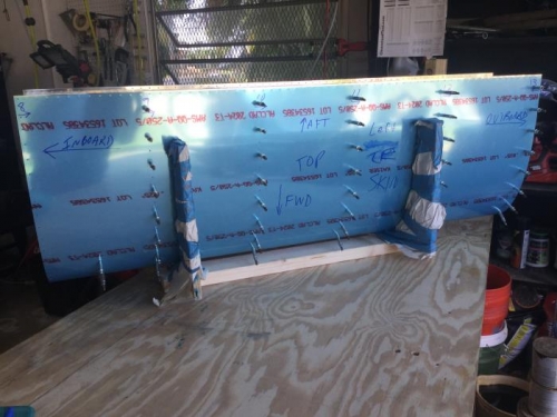

"Padded" LE Stand with packing paper and tape...

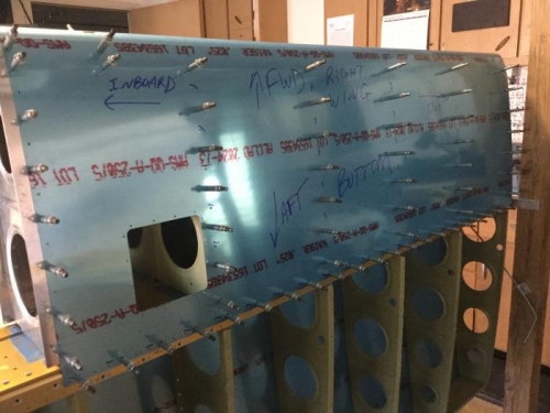

Clecoed LE Ribs (W-709-L) to Skin. Performed a few steps for the Stall Warning system. Most was already done at the factory. Opened up the slot on the LE for the stall activator... Smoothed the edges on the Doubler, Bracket, and "Door."
Clecoed LE assembly to the Main Spar. Match drilled all holes: Ribs to Skin, Skin to Main Spar, and End Rib (W-408-1L)/Joint Plate (W-423) and LE Skin (W-701-L). This was tricky to get lined up, but I think it turned out well.
Had to open up a slot in the Tip End side of the wing stand bracket so the W-701- L Skin can fit.

Left Wing LE in Cradle
