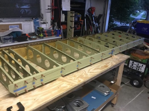

Final Drilled all Main and Nose (not Tank) Ribs to
Clecoed the Main and Nose Ribs to the Main and Rear Spar. Match/Final Drilled them to the Spar Webs.
Removed Rear Spar in preparation for riveting.
Left Wing Main Ribs Clecoed to Main & Rear Spar

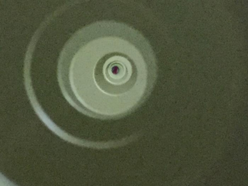

Holes for Corrugated Tubing All Lined Up

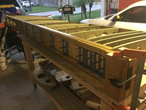

Ribs Clecoed to Rear Spar
