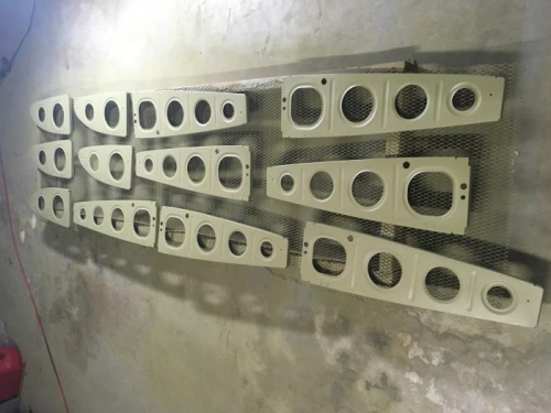

Brief Description:  Prepped Main and Tip Ribs for the Left Wing. Prim
Prepped all the Left Wing Tip and Main Ribs for priming. Countersunk 4 outboard holes in doubler plate on Rear Spar for flush rivets under the Aileron bracket.

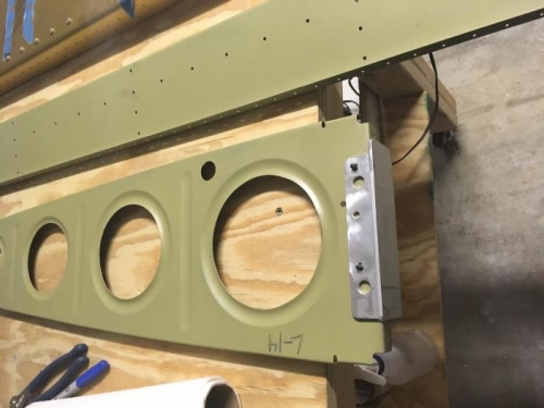

Test Fit Aileron Brackets, Aileron Gap Fairing (interferes with outboard Aileron Hinge), and Flap Brace (need to trim).
Primed all the Left Wing Tip and Main Ribs, scratched Main Spar, and countersunk holes in Rear Spar with Akzo.

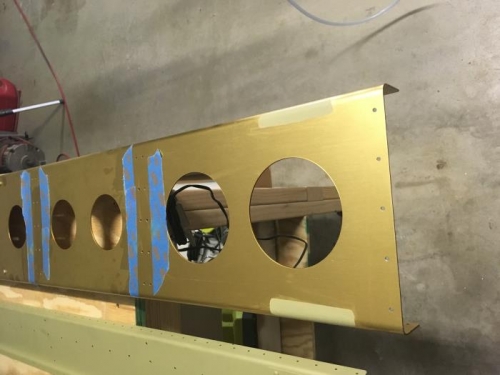

Accidentally closed garage door on Main Spar. Looks like only two scratches on the outboard end of it. I smoothed them out with maroon scotchbrite pads, masked the area, and put on a couple of coats of primer.
Made bracket for hanging the Wing on the Wing Stand. Need 3/16" bolts to attach it.
Left Wing Ribs Primed
Primed scuffs from Garage Door
Made bracket for Hanging on Stand
