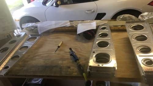

Continued Deburring - Added Cable Holes
Finished Straightening and Fluting all ribs. Had to make some minor adjustments to get the Left Nose Ribs better.
Continued Deburring nooks and crannies. Only the Right Main Ribs remaining.

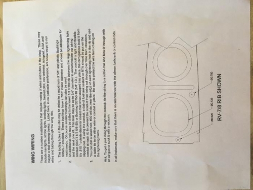

Added 3/4" hole for conduit in Left Main Ribs.
Enlarged hole to 5/8" for wiring to Stall Warner/AOA, Pitot Heat, etc... in both Wings. Stopped at last rib that has two holes next to Main Spar Web.
Added 3/4" and 5/8"Hole for Conduit and Wires
Deburring - Never Ending
Adding Holes for Cables....
