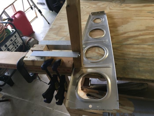

Made Rib Tool, Straightened/Fluted all Wing Ribs
Built a rib flange straightening tool (11 degree offset). Works great but it's tough on the pulling hand.

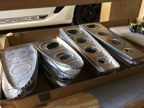

Finished straightening and fluting all Wing Ribs. Did not flute the two ribs that aren't predrilled. Need to mark the hole locations before fluting.
Rib Straightening Tool
All Wing Ribs Fluted
Tough on the Hands
