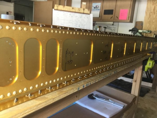

Brief Description:  Nutplates and Tiedowns on the Left Wing
Installed all the Tank Skin and Access Plate Nutplates on the Left Wing Spar. Primed the countersinks before riveting on the nutplates.
Installed the Center Section nutplates (primed the CS's) on the Left Wing

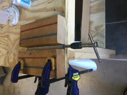

Fabricated both Tie Down assemblies (Left and Right Wing).
Fabricated all four (4) W-726 spacers. Had to make a run to Home depot for a 1" bimetal hole saw and a 3/8"x16 drill/tap set for the Tie Down assemblies.
Need to find a way to secure the spacer plates so they can be match drilled with the Tie Downs.
Tie Down Tap
Tie Down Tap
Nutplates All Installed - Left Wing
