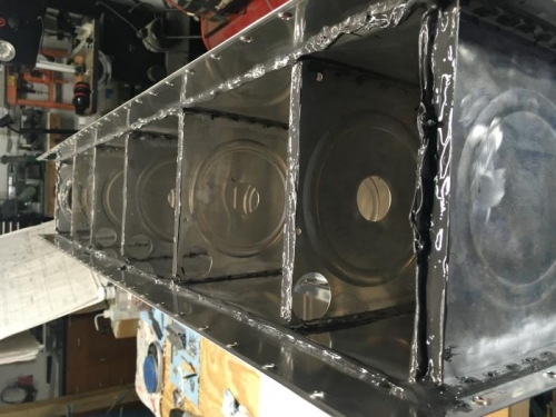

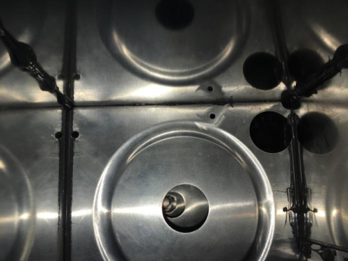

Finished sealing all rivet heads inside tank and any gaps from the original installation. Added a little sealer to outlet end of vent to keep any vibration and contact with the skin down.

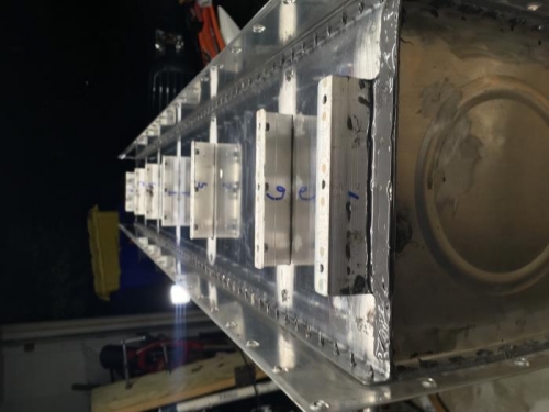

Installed and 100% clecoed the baffle on the Right Fuel Tank.
Riveted all holes on Z-Bracket to Rib interface. Some were a little tough to get started, but using a punch, a little manipulation lined them up.

Pro-Seal Applied
Pro-Seal Applied
Baffle Clecoed and all Pull Rivets and end rib rivets set
Inside tank after installing baffle
