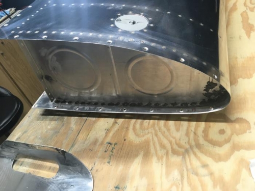

Riveted Rib 7 and covered heads with Proseal.

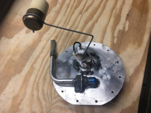

Installed Fuel Sender and Fuel Pickup on Cover.

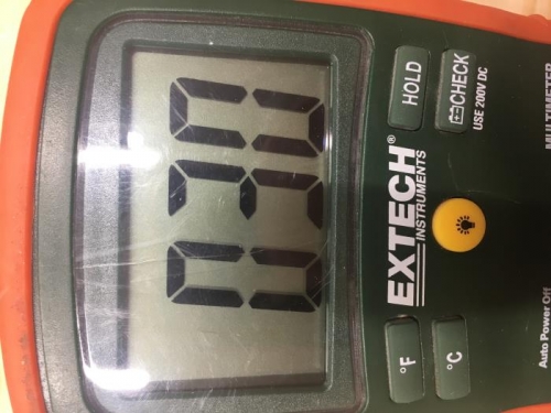

Tested Sender - 030 to 248 ohms.
Torqued PU fittings to 110 in-lb. Didn't have to move the inside nut to make the anti-rotation Bracket fit correctly.
Covered a few more heads in the tank in Proseal.

R. Fuel Tank Rib 7 Complete
R. Fuel Tank - PU and Sender
Empty Reading
Empty Reading
