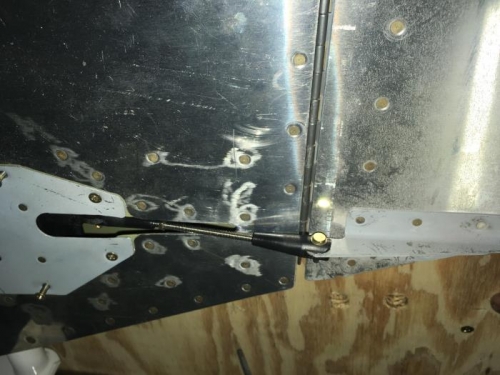

Brief Description:  Installed Electric Elevator Trim
Shaved down the slot for the Electric Trim Shaft. Probably could use more but running out of room. Used a 9V battery to run the trim in and out. Looks like about 17 degrees in the Nose Down (Trim Up) position and 25 degress in the Nose Up (Trim Down) position. Needs fine tuning later

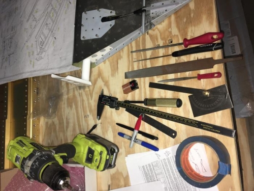

Ordered pins/sockets and crimper for these wires and others hopefully.
Electric Elevator Trim Tab
Tools for getting this to work!
