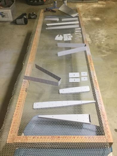

Made a paint platform. Should raise it up a couple of feet.
Primed all the elevator parts. Used the rattle Self Etching spray cans. Very light priming to save weight on the control surfaces.

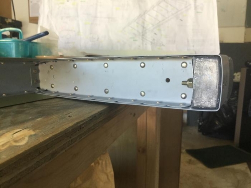

Trimmed the CB Weights for both elevators. Tried a hacksaw, didn't work. It was tough even with the fine tooth, slow speed on the bandsaw.

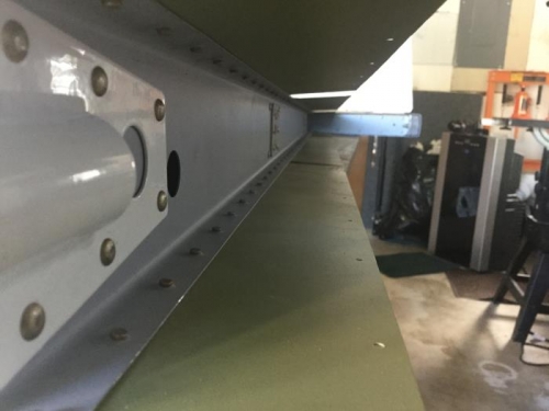

Riveted all but the 4 end rivets on each end of the Right Elevator. Ready to assemble and rivet the Left Elevator
