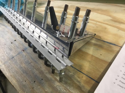

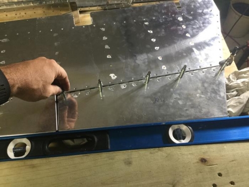

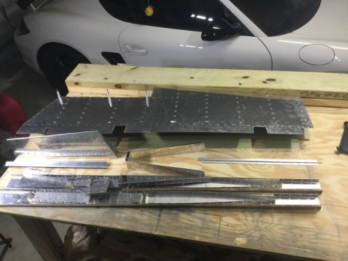

Match drilled all the trim tab skin to spar to hinge. Deburred, cleaned edges and dimpled/CS all the trim tab parts. Test fit to elevator (looks like the gap is too small).
Ready for priming then riveting! Finally!
Trim Tab Hinge
Trim Tab - Too Tight to Elevator
Misc Parts Prepped for Priming
