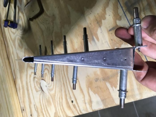

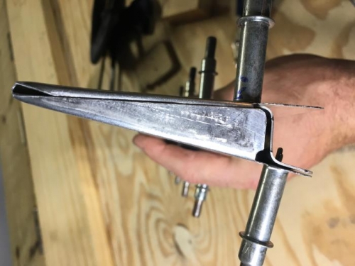

Brief Description:  Bent Left Elevator Tabs, Prepped new Spar
Continued prepping Elevators for Priming.
Dimpled both Elevator Skins.
Completely prepped new Left Elevator Main Spar. Dimples and COUNTERSINKS came out fine this time. Used a backing bar for CS. Did the two next to the flanges without the CS Cage. Just went slow and no issues. Made sure rivets are only flush, NOT 0.007" deep.
Bent all three end tabs: one on Left Elevator and two on Trim Tab.
Still need to match drill and dimple/cs the trim tab, then time to prime and RIVET!
Left Elevator Tab
Left Elevator Tab
