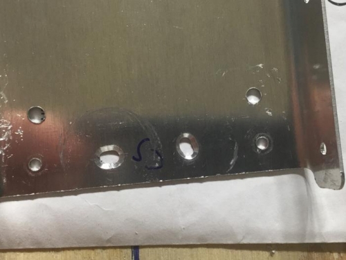

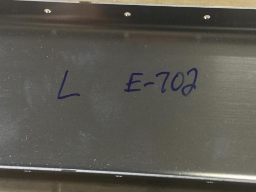

Began countersinking Left Elevator. Immediately destroyed the E-702 spar as the CS bit walked TWICE. NOW they tell me I need to use a backing plate for countersinking thin parts... New E-702 is on order now ($20 plus shipping).
Need to make a backing plate for the rest to avoid the same mistake.
