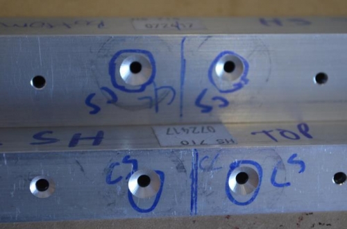

Finished "Front Spar Assembly" by doing the last step. This is deburring, Dimpling, and Countersinking HS702 and HS710/714. The right dimple on HS714 is a little oversized. The depth stop was not locked down and it ended up going deeper than intended. May need to fill, sand, redrill and re-countersink to ensure rivet doesn't pull through when setting.

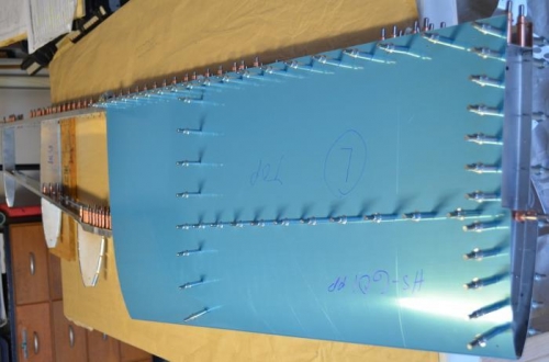

Began "Drilling the Horizontal Stabilizer." LOTS of Cleco and UN-Cleco..... Poor hands.
Oversized CS on HS714
Left HS Skin.
Left HS Skin.

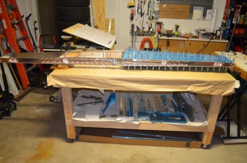

Overview
Overview
