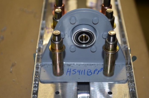

Modified Rear Spar reinforcement plates per drawings/instructions. Primered all parts and final assembly of 411PP (A&B). Had to use -5 instead of -4 in 411PP assembly. Maybe the primer added enough thickness to make the -4 too short. Drilled it out cleanly and replaced, but didn't keep the parts tight. Drilled it out cleanly a second time. Riveted again. All 6 rivets passed diameter and height gauge. Had to reprimer outside of assembly. Second attempt is messier than getting it right the first time!

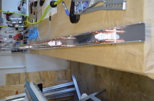

Rear Spar Reinforcements after burffing
Rear Spar Bearing HS411PP
