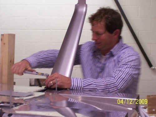

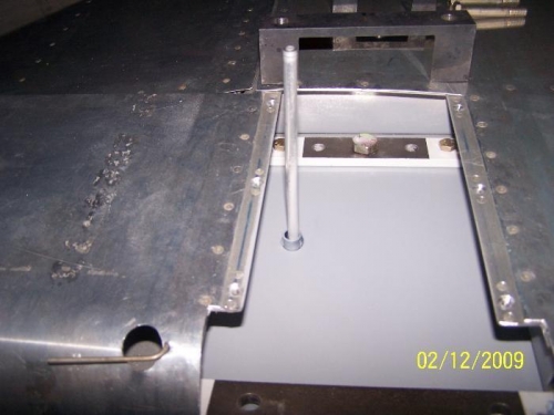

MOUNT AND INSTALL GROVE GEAR
I INSTALLED THE OUTER BRACKET BOLTS WITH THE NUTS ON THE OUTSIDE SO I COULD GET A GOOD TORQUE ON THE BOLTS TO GET THE 003 GAP
