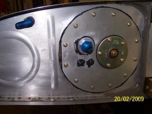

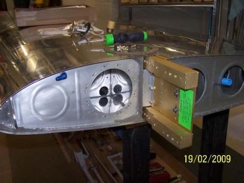

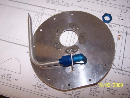

Brief Description:  Installed Fuel Pickup and Sending Unit LH Wing
I installed the LH Wing Fuel Pickup tonight and the sending uint. I hope I used the proseal enough. I found so many leak problems on Vans Airforce site. I used the cork gasket with proseal on both sides. I have not put any on the sending unit yet. It has a rubber gasket and I think It will be find. I think I am going to have to put proseal on all of the screw threads before installing them. Some people are having fuel leak out around where the srews are.
