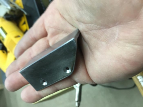

Vic Holmlund (EAA Technical Advisor) stopped over today to inspect my work. Last inspection was 5 or 6 months ago when I finished the Empennage Components. Vic seems happy with my work which makes me happy. Continuing to work on the Ailerons, I had to make a special steel tool out of angle stock to act as a female dimple die. The are some very tight spaces at the trailing edges of the Aileron End Ribs which are impossible to do any other way. The results were better than I expected.

Special Tool (Female Die)
