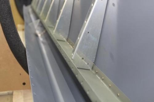

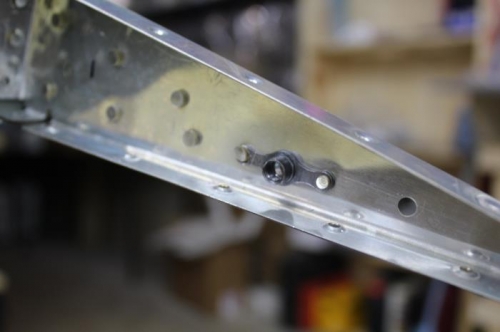

The Flap Hinge Assemblies were riveted together then riveted to the Left Flap Spar. A Platenut was riveted onto the Inboard Rib and all of the Ribs were also riveted onto the the Left Flap Spar. The Left Flap Skeleton is now complete (Image 1). The Left Top Skin and both Nose Skins were clecoed onto the topside of the Spar and Ribs. The Nose Skins were re-drilled to the Nose Ribs with a 7/64" drill and set with MK319BS blind rivets. The Inboardmost and outboardmost Nose Ribs will be set with normal squeezed rivets. The Top Skin was riveted through the Nose Skins into the Spar Flange.
Left Flap Skeleton
Left Flap Skeleton
Platenut for Rod-End Bearing
