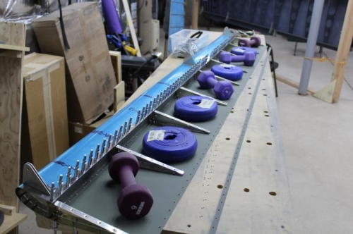

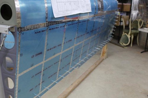

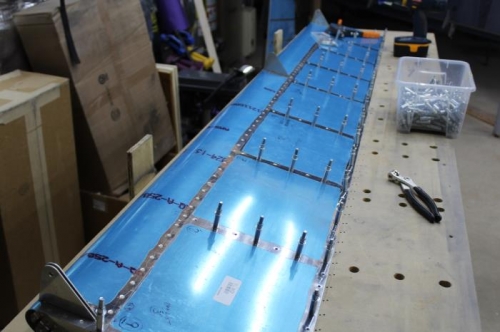

In the morning, I spent more time on the Right Flap. The Top Skin was riveted to the Nose Skins, Spar and Ribs. Ishan came over at Noontime and we worked on the Left Wing Top Skins finishing most of the riveting. We'll hopefully do more tomorrow. Moving back to the Right Flap, the Bottom Skin was riveted to the Flap Spar using weights to keep the Flap alignment from distorting. The Bottom Skin was held open with short 2x4s to enable access to reach in with the bucking bar. I then clecoed the Trailing Edge back down right into the tabletop using the previously drilled holes. Almost done! Tomorrow, I will blind rivet the Bottom Skin to the Ribs and finish riveting the End Ribs with a squeezer.
Left Wing Top Skins Riveted
Keeping the Flap Flat to Table
Bottom Skin Ready to Rivet
