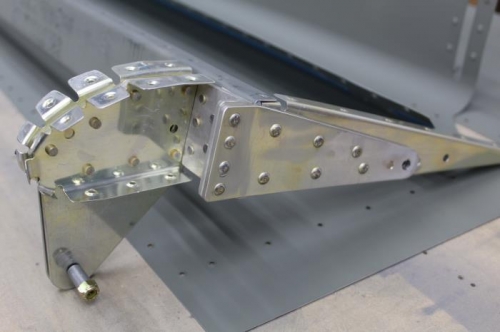

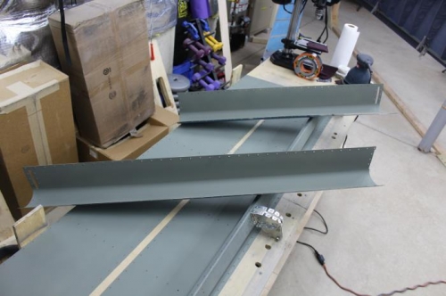

All riveting of the Right Flap Hinge Brackets is complete. those three Brackets were also riveted to the Flap Spar (Image 1). The Nose ribs were also riveted to the Spar. The Nose ribs were riveted to the FL901A and FL901B Nose Skins using blind rivets and regular AN426 rivets as called out on the drawings. Shop Cleanup.
Bracket Riveted to Spar
Primed and Ready Skins
