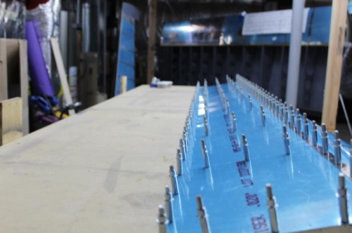

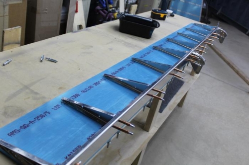

Continuing work on the Right Flap. The same procedure here as was followed with the Left Flap, with the Top Skin Clecoes extending through 5/8" holes in the table. My table now looks like Swiss Cheese. All parts were assembled, clecoed and match-drilled including the AEX Wedge in the Trailing Edge. Now, both Flaps are at the same point in assembly.
Top Skin Clecos into Table
Top and nose Skins Clecoed
