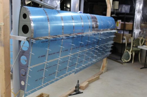

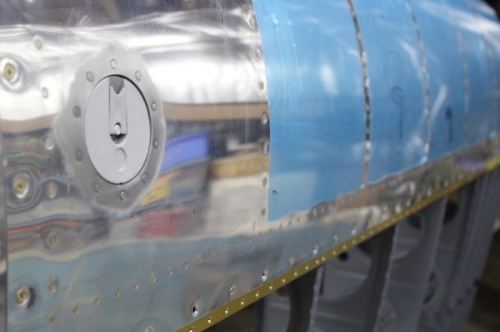

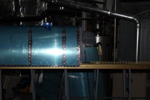

The Left Fuel Tank was temporarily attached to the Left Wing Spar. The bolts are not yet torqued and only every other screw was inserted per instructions. The Left Wing Top Skins were clecoed on for one last test fit before priming and final riveting. Everything looks straight and true. Image 1 shows a laser level in use to show that alignment is quite good. The Skins and Doubler were removed for Priming and both sides of the Wing Walk Doubler were primed. After adequate drying time, the skins and doubler were clecoed onto the Left Wing ready for riveting.
