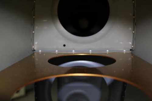

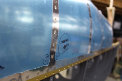

The seven L Leading Edge Assy Ribs were permanently riveted to the Left MAin Wing Spar using CherryMax Rivets. Three sizes were required in different locations. I used CR3243-2, -3 and -4. Using the CherryMax Rivets was OKed by Van's Tech Support. The alternative was to drive standard AN470 rivets which seemed extremely difficult to reach. Shop Cleanup. I'm cutting it short today to visit Rob Carsay at Old Bridge Airport and his RV-12. After a lot of discussion, I decided to hold off on the hangar. I came back home and finished riveting the Left Leading Edge Assembly to the Left Main Spar.
Ribs->Spar with CherryMax Rivs
Left L.E. Attached Permanently
