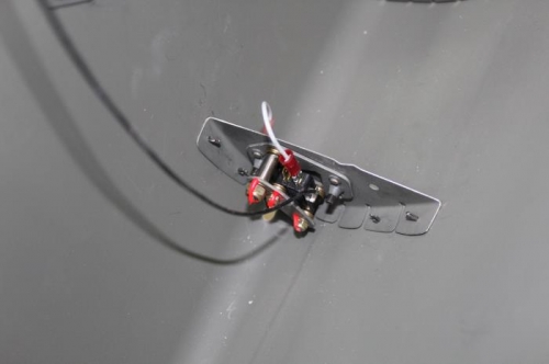

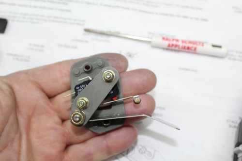

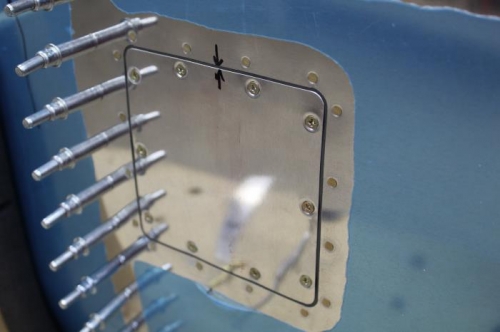

I reworked the Stall-Warner Access Plate with excellent results. The dimples were expanded with the #8 dimple dies and the #6 screws fit much better and very flush with no warping of the plate. The Stall-Warner Assembly was fitted and adjusted in the Left Leading Edge Assembly. It was electrically tested and found to be working correctly. The assembly was permanently installed with MK-319-BS blind rivets. The several nuts and bolts on the Stall Warner were dabbed with Torque Seal to indicte any loosening in the future.
Access Plate Looks Great
Warner Ass'y Installed
