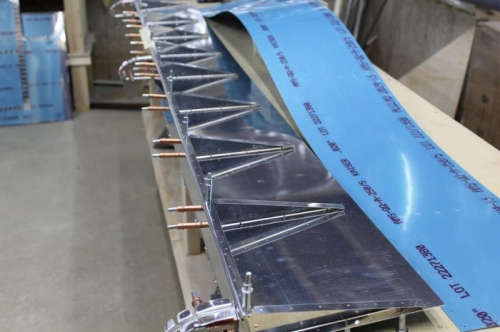

Date:  8-9-2019
Number of Hours:  3.00
Manual Reference:  Section 7
Brief Description:  More Left Flap
I had to drill a bunch of 5/8" holes in the table per instructions to be able to lay the Flap top-down on the table with the clecos sticking through the table. The Bottom Skin was Match-Drilled to the Ribs. David gave me quick lesson on how the read a part of Drawing #14 that was unclear to me - phantom holes beneath the Left Plate (FL906B). He wasn't actually here - we did this via text /photo messages.
Clecos into 5/8
Clecos into 5/8" Holes
Match-Drilled Ribs->Spar
