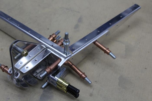

Working of the Left Flap, Nose Ribs, Hinge Brackets and Hinge Spacers were deburred and assembled with clecos. The FL906A Angle and FL906C Spacer were fabricated to specs on Drawing #14. Those were fitted, drilled and clecoed to the Flap Spar, End Rib and FL906B Left Plate (Image 1).
Hinge Bracket Assembly
