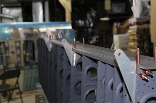

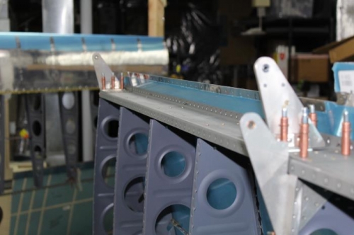

Working more on the Flap Hinge Brackets and Aileron Hinge Brackets. The 2 Aileron Brackets were finished yesterday and the Flaps Brackets were finished up today. Now all 10 Brackets are cleaned and Alodined - ready to rivet permanently in place. A Bushing was pressed into each of the six Flap Brackets. With all brackets clecoed in place, alignment was found to be very good.
