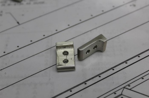

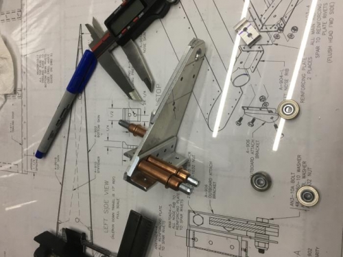

Started working on the W913 and W914 Aileron Bracket Assemblies. I had to fabricate two small Aileron Control Stops from stock aluminum angle. I prepared two of the four needed assemlies today. All parts were match-drilled, deburred, cleaned with AlumiPrep and Alodined.
Aileron Bracket Parts
