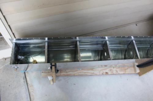

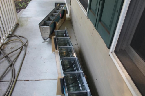

Brief Description:  Water Test OK!! Work on R L.E.
Tanks OK!!! Of course, only the forward 2/3 of the tank can be tested with water... the Baffle is not on the tank yet. Tanks were drained and dried out. Ream Rib 7 and Splice Strip dimples on L.E. Countersink and re-Alodine the holes in the Main Spar. Re-assembled the Right Leading Edge and started to rivet. I quit after 1 1/2 Ribs out of seven. Lost rivet mojo for today.
No Leaks So Far
No Leaks So Far
No Water Leaks
No Water Leaks
