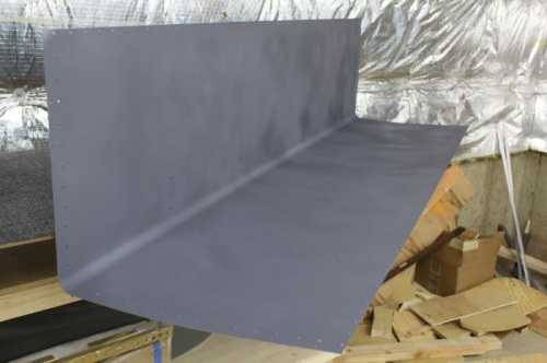

Brief Description:  Work on Right Leading Edge Ass'y
Continuing on the Right L.E., the 7 Ribs were cleaned and etched in Alumiprep. The inside surface of the R Wing Skin was roughed up and cleaned with Scotchbrite and wiped down with Acetone until clean. I sprayed the Ribs and the inside of the Skin with primer. Earlier, I put both Tanks out onto the front porch and filled them with water up to the Fuel Senders. I'll leave them overnight and and look for signs of leaking tomorrow.
Primed Leading Edge Skin
