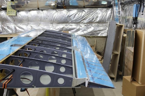

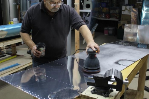

The Flap was test fitted onto the Right Wing. No complaints. Everything lines up perfectly. I consider this to be a testiment to Van's engineering. The edges of all four Bottom Wing Skins were deburred with a hand file and Scotch-Brite. I was able to scuff up one of the four skins today. The most effective method I've found was to strap a Scotch-Brite Pad to and Electric Buffer. Works very well and very quickly. (Image 2)
Right Flap Mounted
Right Flap Mounted
One Skin Scuffed Up
One Skin Scuffed Up
