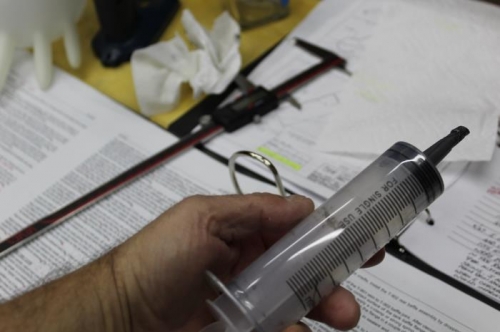

Brief Description:  More Goo and Work on Leading Edge
I mixed up an 80 gram batch of Pro-Seal and stuffed it into a large syringe. I wanted to touch up any suspect areas of potential leakage in the Tanks. When the baffles go on... the inside of the tank will be inaccessable. I totally disassembled the Right Leading Edge, deburred the skin and dimpled the Ribs and the Skin.
100ml Syringe
