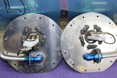

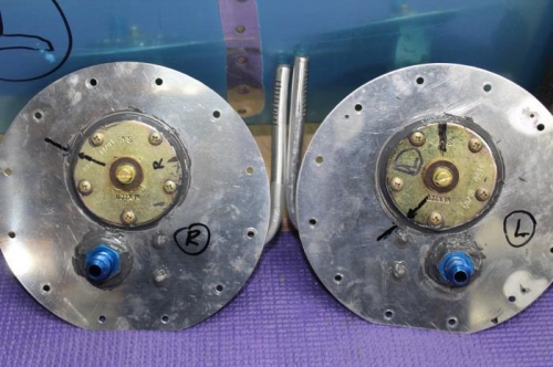

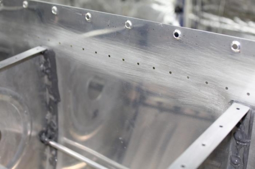

Cork Gaskets were made for the Access Plates as specified by Van's. ProSeal was applied and final assembled. I prepared the inside of the tank skins and the mating surfaces of the Tank Baffles by abrading the surfaces and cleaning with acetone to insure a good cleans surface for the ProSeal to adhere. (ProSeal requires very clean surfaces to insure a solid bond)
Outside of Access Plates
Inside of Access Plates
Preparing for Baffle
