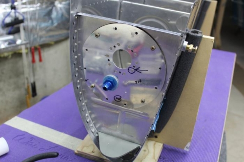

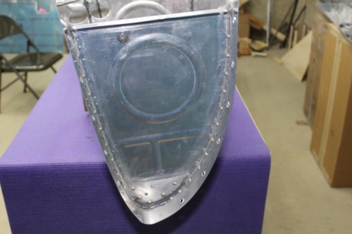

Brief Description:  Right Tank, Bracket and Plates
Finally finished installing all of the R Tank Ribs w/ ProSeal. The end ribs were the last to be done. The R Tank doesn't have ProSeal slathered all over the outside as does the L Tank. When doing the L Tank it did not occur to me that the End Rib rivets are actually on the OUTSIDE of the Fuel Tank and don't need to be sealed. The T905 Bracket and both T410 Reinforcement Plates were installed permanently. I spent so time cleaning everything... ProSeal is messy and gets everywhere.
R Tank Inboard Rib
R Tank Inboard Rib
R Tank Outboard Rib
R Tank Outboard Rib
