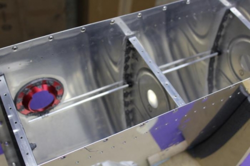

Date:  6-14-2019
Number of Hours:  3.50
Manual Reference:  Section 7
Brief Description:  Vent Line for Fuel Tank
Started fitting the Left Fuel Tank Vent Line. Venting is needed to allow air into the tank as the fuel is used... otherwise the tank would crush from the resulting vacuum at the top of the tank. I also started making the Fuel Pickup Lines for both tanks from 3/8" aluminum tubing per drawing. The bulkhead fittings were loosely installed until final installation. I'll move on the right tank at this point because I have to wait for a Tubing Bender and 37 Degree Flare Tool to come in the mail. Just ordered them today.
L Tank Vent Line
L Tank Vent Line
