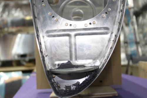

Brief Description:  More Left Tank Ribs and Bracket

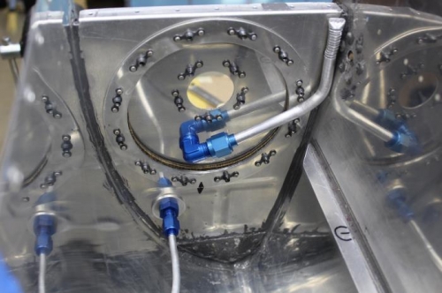

Two more ribs were installed today. ProSealed and Riveted. I'm guessing that each rib took half the time to install as the first on done yesterday. Two seems like enough for one day... such a pain in the ass. I also installed the T905 Bracket and Reinforcing Place on the Inboard Rib. Image 1 shows the Bracket but I failed to snap a pic of the plate... so Image 2 is actually from the future (6/20/2019) to illustrate.
T905 (Tank->Fuse) Bracket
Plate Shown at Bottom
