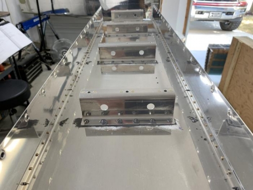

Installed Right Tank Baffle and Z Brackets

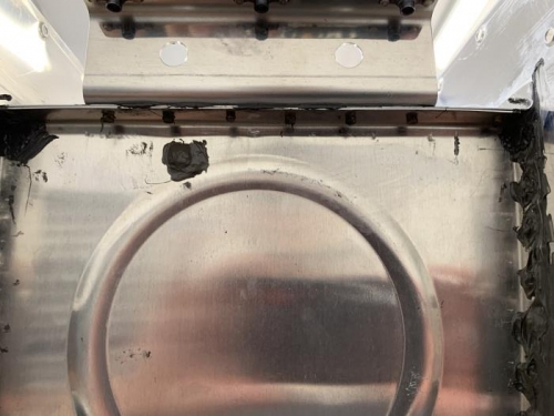

One thing to make sure is to follow the directions on placing thin proseal on the rib ends and a line of proseal right after the rivet lines for the back baffle.

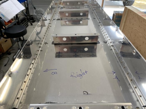

Notice the direction of the brackets
Z Brackets in postion and Riveted
Outboard Z Bracket
