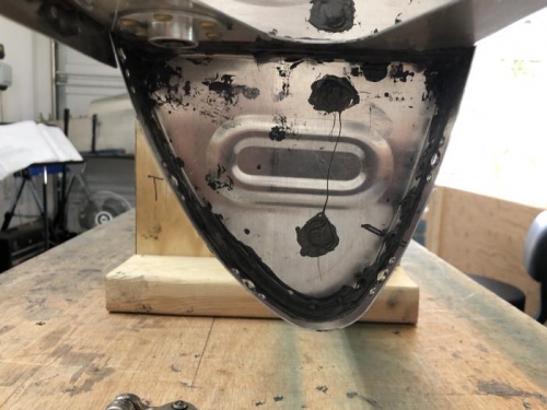

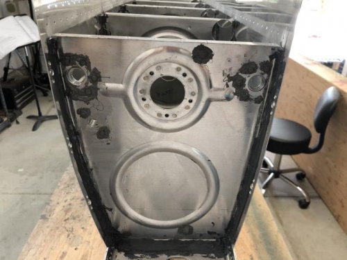

Fuel Tank Bracket and End Rib
There are a lot of logs saying there is leaking here when installing the fuel tank bracket. Just make sure you use the Proseal where those gaps are. It is hard to see the underside of the bracket that is forward in the tank. Proseal is MESSY!
End Rib Aft
End Rib Forward
