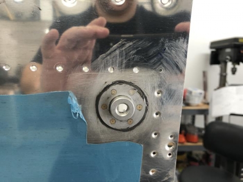

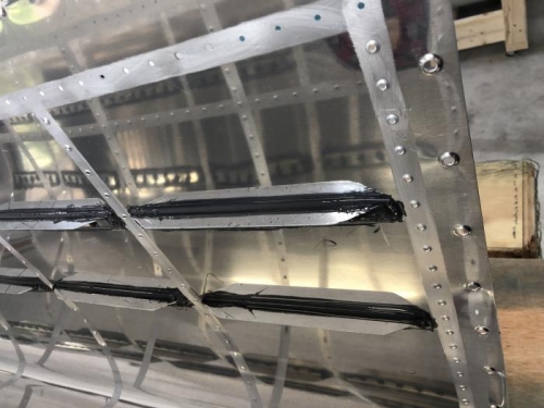

Wet riveted the stiffeners, fuel cap and fuel drain. I used a Semco gun and a 6 oz proseal cartridge. I used about 3/4 of the cartridge within the 2 hours allotted time. Double gloves is really recommended and clean up with MEK. As soon as you are finished riveting, clean the surface. It comes off easily if you catch it right away.
